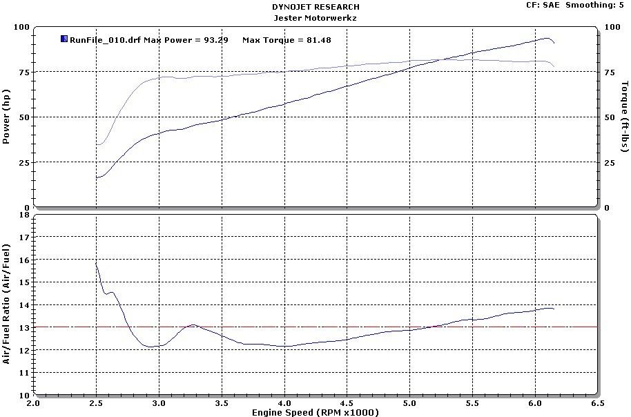

This belongs to Member "Wedge"
Flat top 1250 with home ported XB heads,560 cams,42 Mikuni,V&H Side Shots exhaust
You can really see where the 560's are killing the bottom end below 2800 RPM, but that's not much of a sacrifice to see the torque jump right up there and stay strong to 6200. That's all within the riding range of most people.
I was as surprised as anyone that the bike doesn't feel as bad as that chart (and my expectations) were. I rode to LA this morning (Vernon) and was in the usual LA traffic on surface streets. The bottom end doesn't suffer at all to where it's noticeable.
Where the issues show, and it's where I expected them to show, is starting when the bike has sat a while and the charge may not be perfect. It only has about 120# of static compression, but once it fires up and the air gets moving, it will put a grin on anyone's face. After a cold start like that, it starts perfect every time unless it sits for a few weeks again. (I still prefer my Roadster, so it sits quite a bit).
