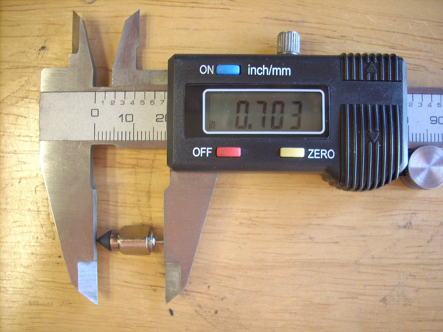

Update: Pulled the petcock to check on my filter. It seemed like maybe gunk got into my float bowl and caused my float valve to stick. The filter had completely come off from the petcock which was quite surprising to me. I plan on rebuilding the petcock filter later but didn't want to wait for the parts. Reinstalled everything and put an inline fuel filter, and seemed to run great.
Went for a 2-hour ride and on the last 30 minutes, it started struggling a little bit at stops and kind of wanted to die. I thought it might have been slightly flooding even though there was no visible flooding. Got it home with some moderating the petcock. Pulled the carb cover and there was visible gas in the carb.
I ordered a new float valve the old one didn't seem to fit the rubber gasket perfectly, so I am assuming it might be running rich from the float bowl?
Does this sound correct? Also, going to recheck float level. However, since it ran for 1.5 hrs perfectly I still feel like the float valve is just having issues.

As I recall the long one throws the float level waaaay off !
Where if you set the level to spec the bike runs out of fuel at WOT in 2nd gear.

Ordered a new float valve from cv performance. I think the old neoprene tip was coming off the valve and causing it to get stuck open. Installed new valve and set float level. This seems to have fixed all the issues. Thanks for all the assistance gentlemen!
