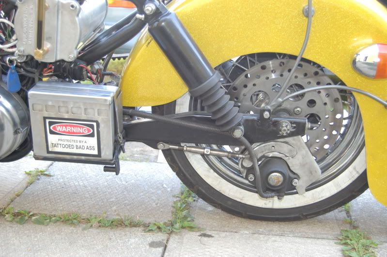

This is the best picture i have for now to show battery location. I used the original battery tray, bolt the front of the tray to the passenger peg hole, drill and tap another hole for the rear bolt and voilà. Hope it help.
oups, find another one....
