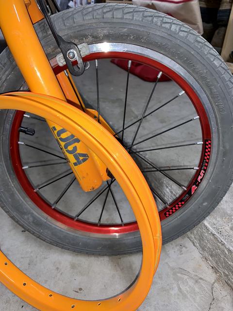

When I was a school trained junior mechanic in an H-D shop in ‘74 I made 4.00/hr.
I took wheels home at night and sat with my woman listening to Hendrix and lacing and truing wheels on an old swingarm. Both HD and Bultaco.
I made $30 a wheel. No wheel ever took me more then 45 minutes once I got my “technique” going. It’s an art worth studying. Even today.
Just last month I re-rimmed my 7 yr. old great nephew’s BMX bike. He looks at me differently now. So do his pals.

So, the Bultaco rims were by far the ones I replaced most often.
Putting a 16” rim on an XL hub with the proper offset was also a big money maker back then.
This stamped orange rim is only twisted. The other one like it was really bent up. The machined aluminum, double wall units were only $16 each on eBay from Hong Kong. Very nicely made.
I had to buy a 2mm x .045 die to lengthen the threads on the spokes but it all worked out great. He loves the bike and it’ll be ready for his little brother too.
