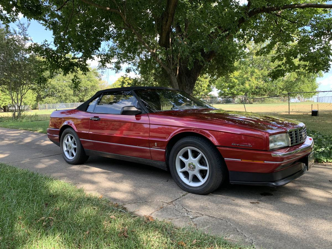

Also..have Ya ever worked on a Allante? mines a 93 with the Northstar engine,
its time to replace the alternator. Seems hard to get to it...wondering if Ya have done one.
