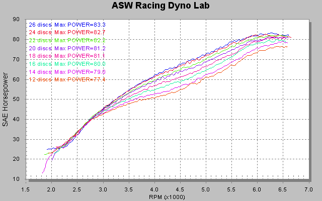

One thing is for sure, it likes the closed end cap w/26 discs...I'm getting some tables increasing as much as 15% over the open ended cap (the end cap with the hole in it). My 3k rpm valley is diminishing as well.

Yeah, years ago I did that test on my '04 883/1250 ...

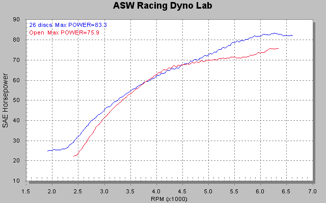

I also tested with nothing on the end of the muffler just for grins ...
