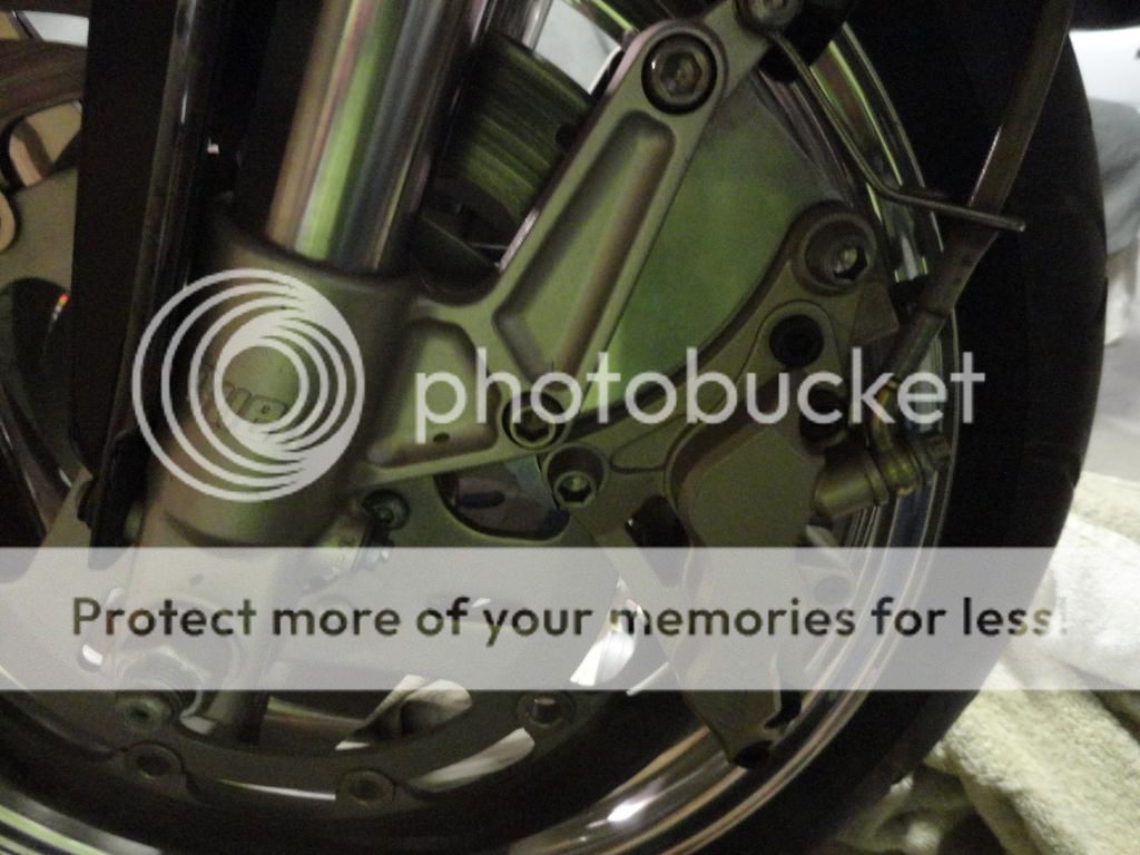

right side
left side

What is the left side caliper off of? Is the the match to the right side? I think that is brake porn!

That caliper looks like a six piston Nissan. The Suzukis often used tokikos spelling could be wrong on that but some of them used Nissans which also is what came on the later tube framed Buells like your X1. The difference is that the Buell oem caliper is speced with different spacing and that is why the bracket is needed.
The Nissans were also oem on some of the MV Agustas. They are a good caliper. Steve
