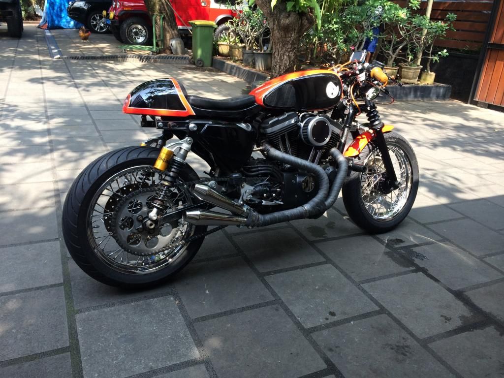

There's lift kit from Freespirit so you can use your existing shocks...I think it adds about 1.5"...I am using them on both bikes.

That nightster is looking good man! What tank and tail section is that?
  #37
Old 15th October 2014
Thanks mate....custom tail and narrowed Sportster C tank so I can use original fuel pump.

I thought that might've been a C tank! Are you using stock mounting point on that or have they been modified? It sits really good on your bike!
I enlarged the mounting hole on the tab so it can sit lower by abt 1cm.
