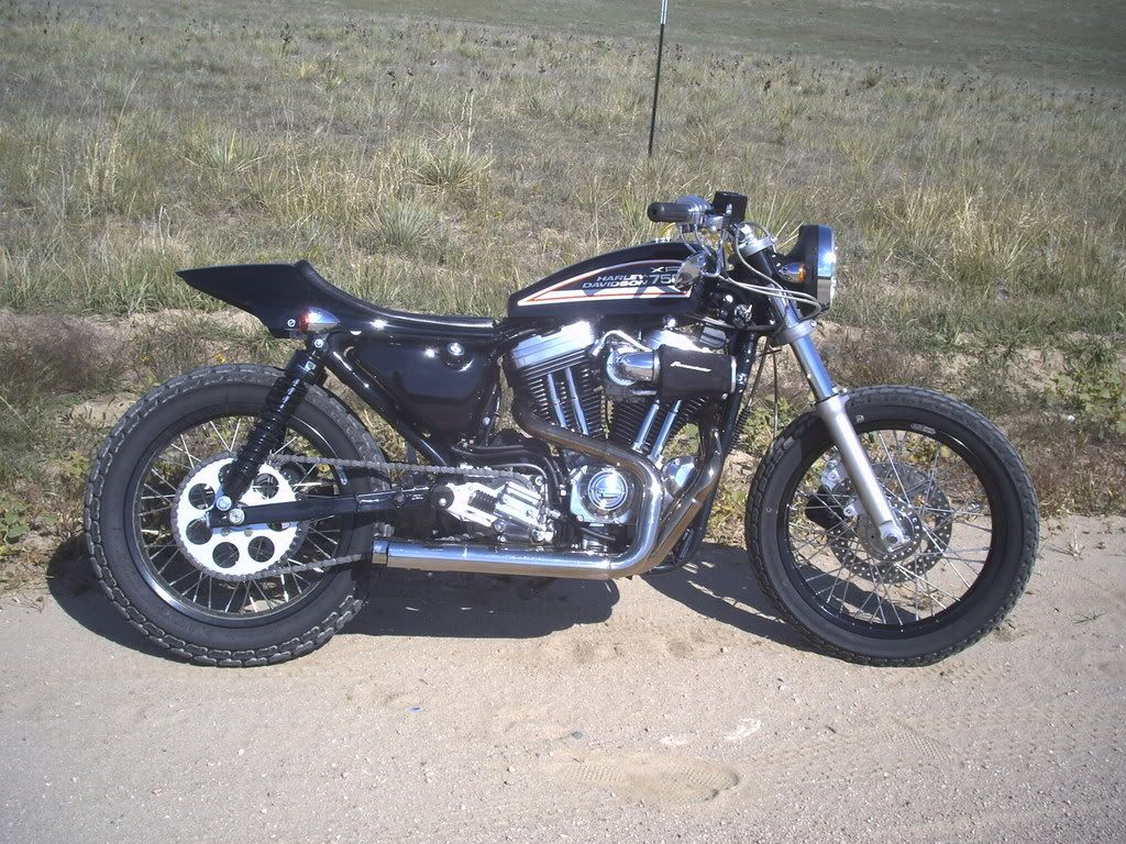

Thx for all the replies, guys. I don't want to get too high. I like the looks of these:
Ralphthe3rd's bike
What length do you guys think? I'm guessing the 13.2" ones, although Ralph looks to have 11"-ish.

Lightbulb MY Shocks !
I have Progressive 418's in 13.5" length on my bike...
MY BIKE- with MY 13.5" 418's !

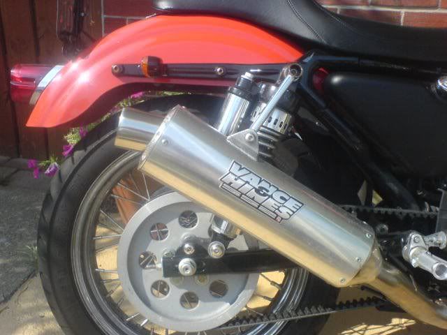

15"-ers with an 18" wheel:
Garrett302
