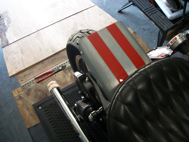

Actually I had a body shop clear coat it, I have used 2K a few years ago on a fender I built, it laid down really good, painted it outside with no mask however I held my breath as I sprayed and made sure I was well clear of any mist before I took a breath and, I wore long sleeves and made every effort to keep it off me, now there was 1 little pin head size flaw in the clear, barley noticeable, after about a year I was blowing the bike off with my air compressor after a ride, got a little to close to the pin head flaw, and the clear just started peeling right off, the fender was a mix of duplicolor engine paint and the zinc coating that came on the fender, the zinc may have been the problem, I did scuff it and applied adhesion promoter, so long story short I felt more comfortable with professional clear ($125).
Fender
