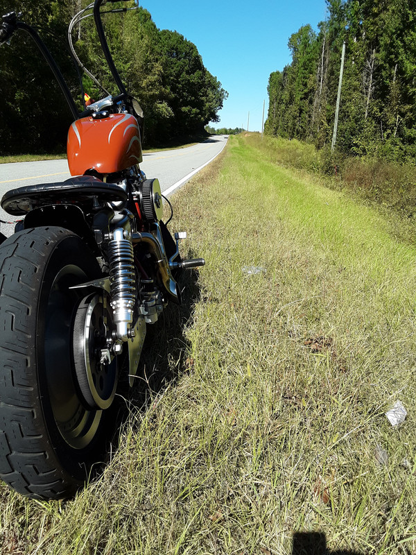

I got these from J&P Cycle, it's their "premium" shocks, these are 10" but they come in different lengths, the 10" are dual valved, the longer ones are mono pole, they are very beefy and adjustable (preload /height) good all over performance, like I said these are 10" set my sage and have very little bottoming (I weigh in at 185) I paid $169 for the pair a year ago, they also come in chrome or black.
