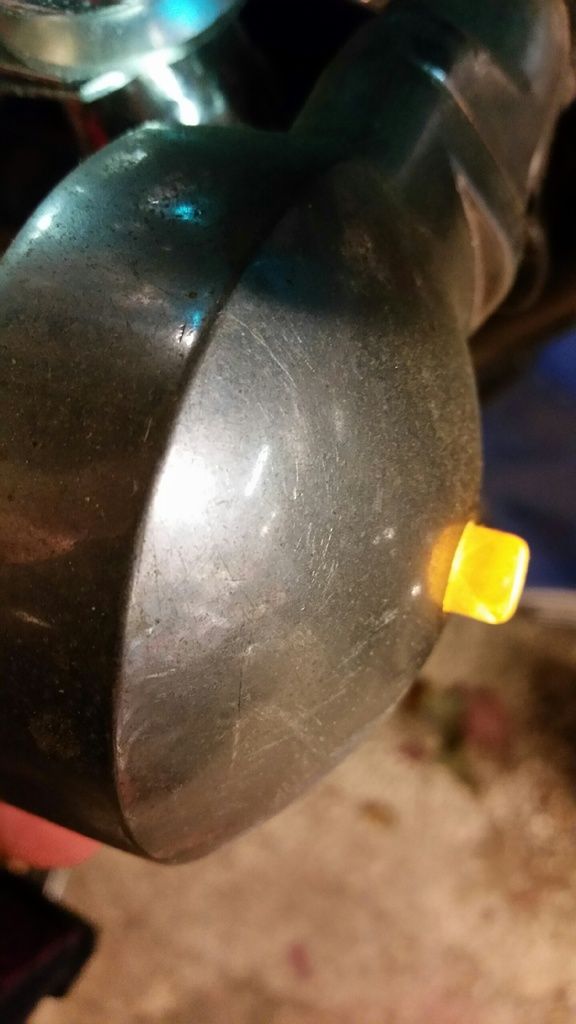

Ok I found infos in the 1954-78 Part Catalogue:
The 68552-70 was used for 63 to Early 73 XLH and on 70 to 73 XLCH
The 68514-73 for Late 73 to * on XLH XLCH.
The 68552-70 is a flat Lamp, the 68514-73 seams to be the same as the one I have on my 1992 XLH when new.
The 68508-64 is perhaps the same as the 68552-70 except for 6V then 12 V.

So a a front turn signal 68552-70a existe with a rear nipple to show that the turn signal is on work !
Perhaps not a good idea to use turn signal on a no-battery bike, but may help for my 1964 FL. when I have to drive in France.
As I understood, the turn signal for Sportster and FLH are the same flat light till 1973 and then the Sportster's one are different type for a long time.
