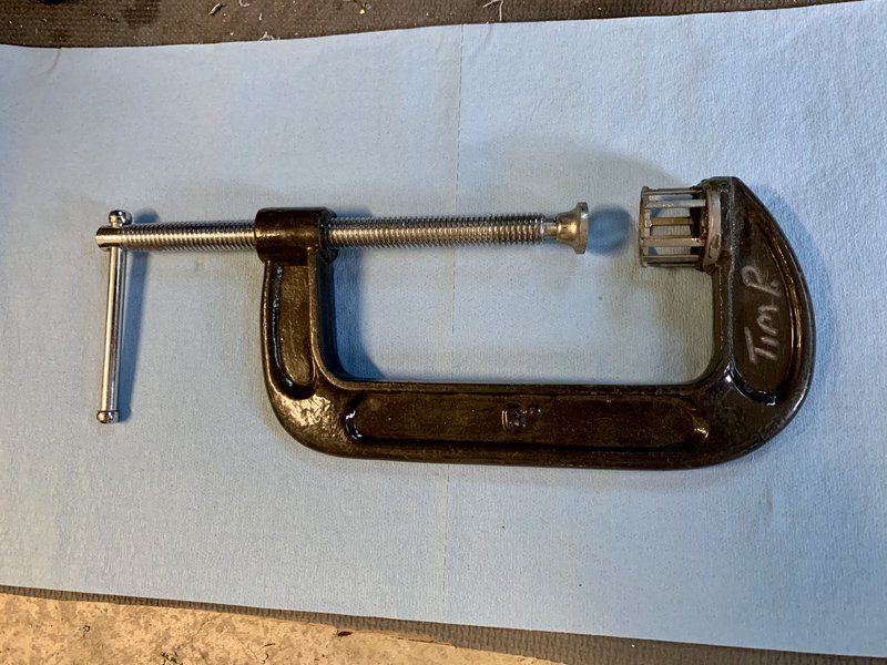

But you can make one out of a C-Clamp and a bearing cage like I did.
