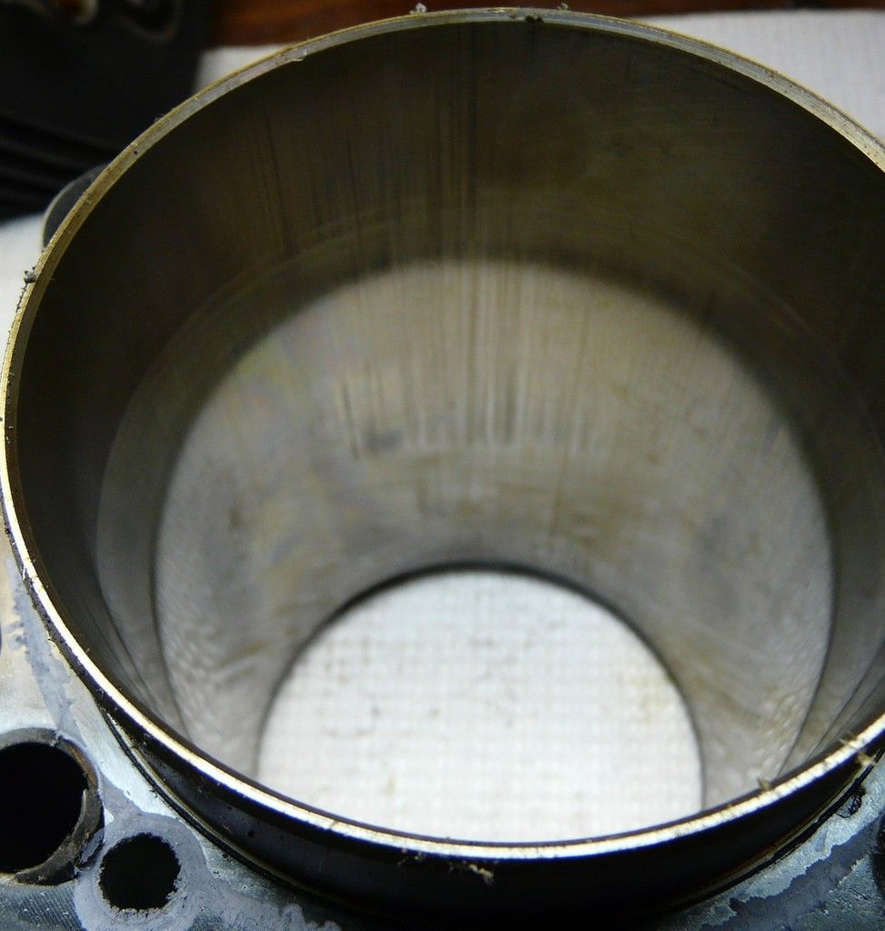

I purchased a 2000 X1 with some bottom end noise, PO had taken her apart and was deployed to Afghanistan. Came home and is leaving the area and did not want to tote her from here in NY to Oregon,, so,,, got a project here to go with my street XB12R
At this time,, I am not sure if she will be put back or if the costs to get the engine up to snuff are too much,, Ima will have some parts avaiable! LOL

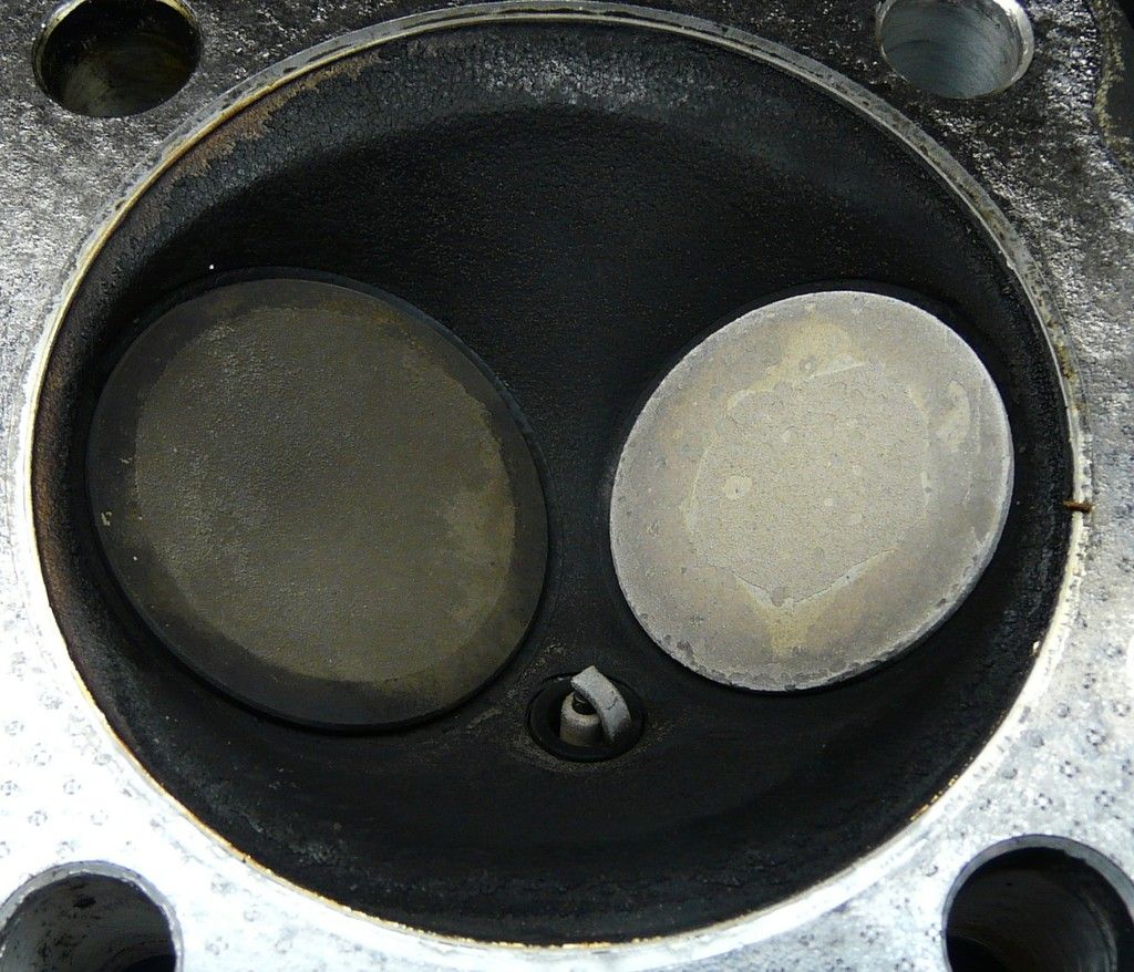

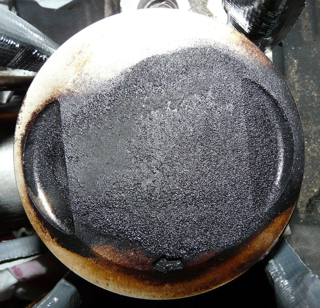

So first up are the heads, piston tops and jug shots

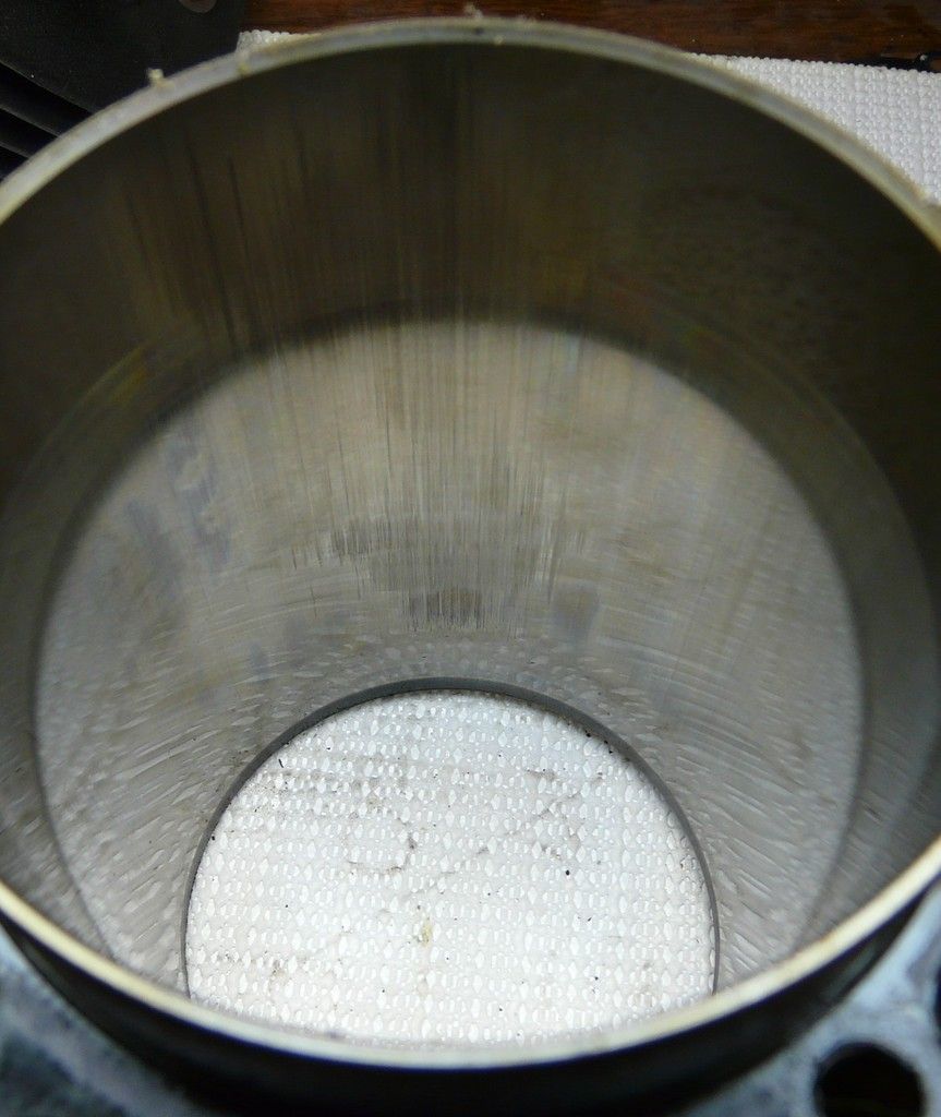

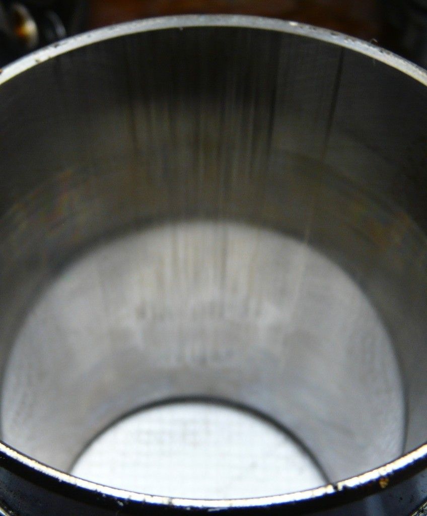

Front head, one exhaust stud has been reamed off center when I check with my Jims Tool, left motor mount hole has broken bolt but has not been butchered. Cylinder bores show a lotta slapping,, think they are in need of attention even without pulling out the micrometer.
Front Head Casting #
Combustion Chamber, Piston & Jug

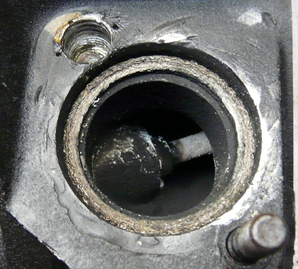

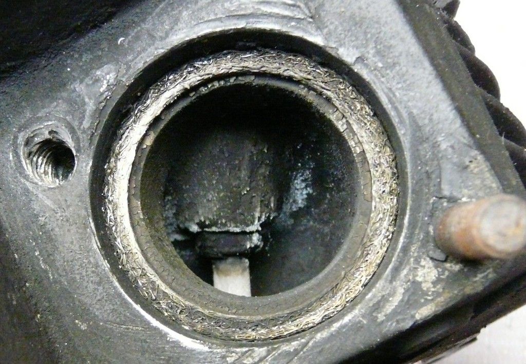

Rear Head has been overdrilled on one exhaust stud,, really beyond helicoil repair,,, will need some help of this one,,
Rear Head Casting #

With the obvious faults evidenced do a complete tear down and thoroughly check it out. Could very well be worth the investment if you bought it right to begin with.

I responded to your PM. What is the crank doing? if you pull straight up and down on the rods do you feel movement or is it just side to side? I have seen too many times where folks are told their crank is bad and really their is nothing wrong with it.

About .125 up and down, outer bearings intact, have not split the cases yet.

Good morning!
Had a really nice talk with Dan last night,, NRHS is going to assist me in this motor!
Plans are to have heads cleaned, welded to repair stud fubar, examined for seat/ guide condition,, probable added work,,, thinking here about some port work... woke up from a CNC dream....
1250 kit rather than bore, hone and size rings... I like the idea!
And,,, thanks to the saving graces of Dan,,, he has a crank!
Now to get me a heavy box and get the heads shipped!
Thanks again Dan!
