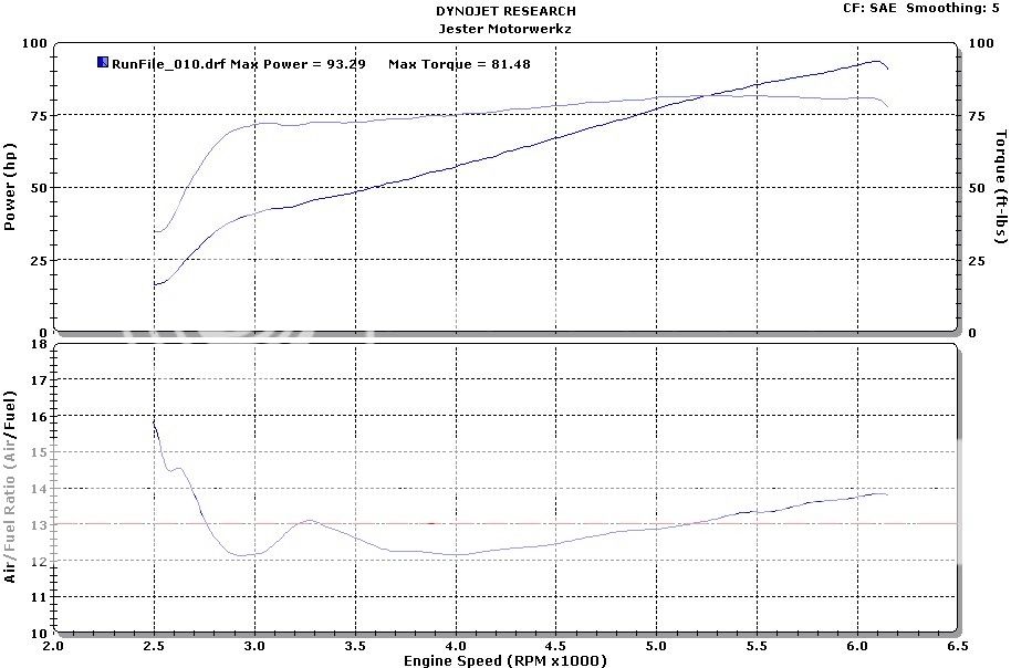

This here is Wedge's junk yard mule
1250 Flat tops
Home ported XB/XL heads
560 Hammer Cams
Ported SE Manifold
HSR42 Mikuni
V&H Side Shots Exhaust
Daytona TC88A Ignition
Notice we only ran it to 6200 RPM !

I think that 88hp is going to be really close there GB. I should pull a little stronger in the low and middle than the mule tho. I should have a 42 by the time I dyno too tho I don't think jetted right the cv will hold me back much up to around 90.
