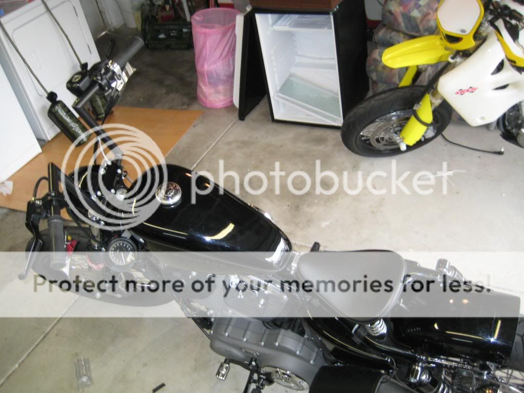

Need help here. I striped off all the turn signals, the switches that operate them, and want to nick the alarm. Here is the deal. I canfix any thing on a carbed bike but this is my first bike with an EFI and a super computer. My intentions are to get rid of everything useless and take my 2008 nightster to bare bones essentials got as far ass I can go without help. I have rewired the electrical on the front of the bike to move all the switches under the tank and off teh handle bars.
I no longer have turn signals. Do I need a TSM or can I just run a relay to it.
Also I want that beyond worthless alarm off my bike and the space it is taking. I have no idea what it is comprised of in parts. what plugs/harnesses/unit/sensers belong to this retarded thing.
If anyone wants it it is yours just send me the TSM and I will send you the alarm, and the tssm. And if you could tell me what is all part of it.
What can I strip off that is electrical that won't hamper the operation. This thing is a wiring nightmare. To make it a simple bike I need to go through a difficult process of rewiring this bastard. Oh I have all hte stock switch housings if you want them as well.
So any help about this is appreciated. And I know that if I get the TSM i will need to marry it up. Butis it ness. as I don't have turn signals and am nicking the alarm.

Thanks, Nah I don't care about the tip over switch. If I tip over the bike is gonna be hammered and me in a hospital. Do you know what the three plugs are between the fender and oil bag? And where is the tssm. What does the antenna look like? I moved the ECM to hide that POS cause of the seat I have. It is zip tied to the battery. This thing has stuff the tech at the dealer ship has to guess about. Which is why I am here. This guy at the dealer ship was trained to work on these and needs to guess. I figure talk to people who have done these types of things. Although what I am doing is more then most people on here have done. Everything I am doing is irreversible. No more stock.
