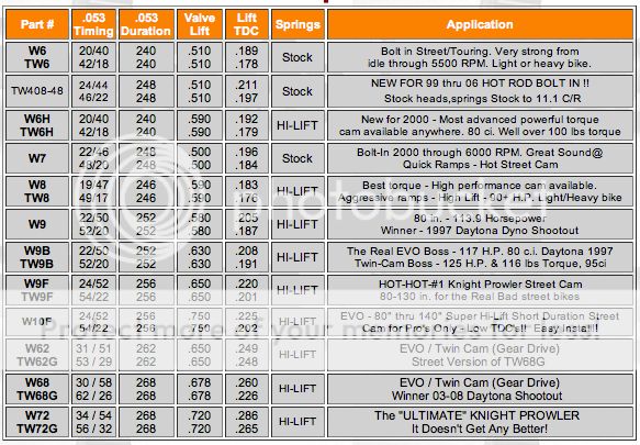

Are you sure those Wood cams have a small base circle? I have some Wood W68S cams and they have a stock base circle and .678 lift.
Aswracing, Much appreciated for your great feedback!
I called Bob Wood when I was gathering my data. My cams are W-8S 2000, 0.590" lift, as marked on the box. My model year bike is an standard 883 XL 2000 Model year (modded of course). He assured me that my base circles were not the cause, but not sure if he said small base circle, or stock base circle. But said cam circle couldn't be my issue with what I described to him. I'll have to call and double check again base circle size, been looking at so many different causes, my mind got side tracked.
