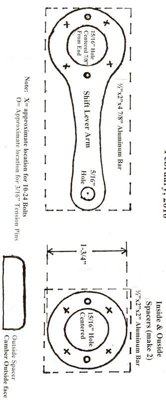

Here are some templates that rasaine shared with me some time ago, when he was still on Version 2, the laminated unit. Awesome, nice guy.
Edit: I see these templates are included in the PDF Instructions file rasaine attached to post #26.
