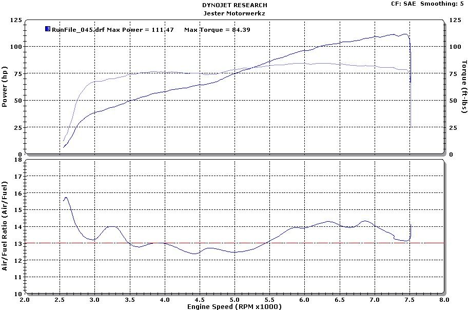

Mine
Hammer 600 Cams
HSR45 Mikuni
Thy Sportster Come
It Shall Be Done
On Earth as it is on Salt
2006 Sportster XL1250C
Hammer 600 Cams
Big Ass CP/Hammer Pistons
Jetted 27.5 slow,182.5 Main
97 Needle,Clip posistion 3
Alto Carbonite Clutch
Patriot Defender Pipe
Napa 7148 oil filter
Max Power, 111.47
Max Torque, 84.39
Best 1/4 Speed to date 115.14

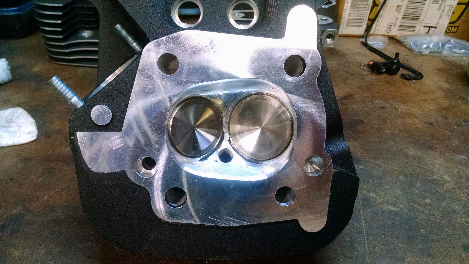

Now the question becomes, what to do with the heads. In the GM LSx engine world that I’m most familiar with, stock heads pick up a lot when ported with the majority of those gains are coming from the valve job and milling, not the cnc port work. So that’s kinda got me thinking of just a $200 competition valve job versus the impact head porting for $550. Thinking it may give a little boost everywhere but I’m not opposed to doing the impact porting if it makes sense to.

These are about 800.00 Bucks
I've been thinking about those. Damn you! Maybe when I get the settlement in my personal injury case. I'm hoping to get enough to get me thru to early retirement. I have to get past the work comp issues first tho. Hard to believe it's been 5 months since the crash. I still don't remember a thing about it either.
Maybe wrkdWS6 will jump on them. I'm not sure about the compression ratio with the 570s tho. Might have to use thicker gaskets.
Error wait...those are your crushes right? Not your SEs. They'd be the cat's ass with the 560s I bet. With a 1275 that would be well north of 100hp. Maybe 110.

I do like compression !

I was gonna say you could never have too much head lol but I think it's more head than I need for this setup.
Yeah, me too. I might play around this winter on cleaning the ports up but really these xb heads do quite well in stock form. Porting them when running 570s has little benefit. They can vary a lot tho in casting flash. I remember Wedge saying 1 of his was pretty good but the other wasn't. Mine both appeared to be about the same. I just cleaned them up as far as carbon goes, cleaned the valves up in a drill using a scotchbrite pad to get the carbon off then 2000 grit in a bowl of water to polish them up and lapped them in and new valve guide seals obviously. My old ones were leaking pretty good which is why I pulled the valves out in the first place.
Then again I might just run them another year first then have Hammer do a competition valve job and put new springs in just to freshen them up and clean up the ports a little myself at that time. I only have 30,000 on the heads and oil has always been changed in 1500 miles or less. Service records from the previous owner who had my Indy do it showed the same.
George with his Hammer 600 cams on the other hand...with that kind of compression AND valve overlap...120+hp? That's a f'n beast! I can only imagine that ride.
