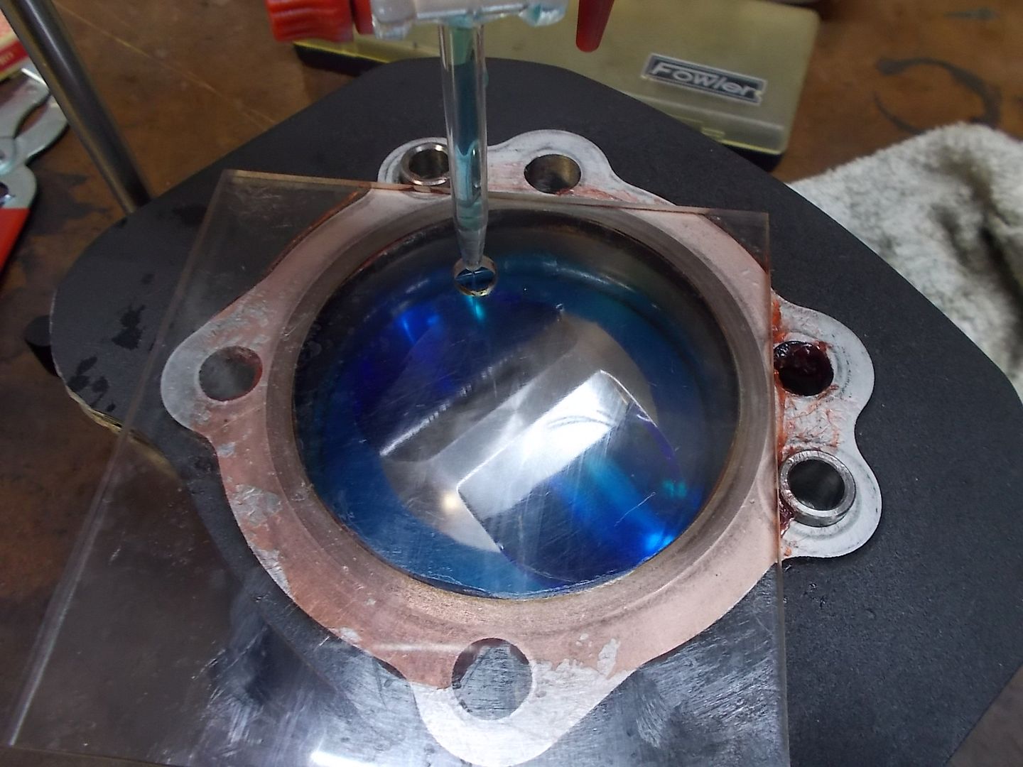

Originally Posted by madnss View Post
What's the number to punch in for the piston dome on the 30° domed pistons?
OK, so we have 30 degree 1250 pistons in the following dome sizes:
  • -1.3cc
  • .35cc
  • 9.7cc
  • 11.35cc
  • 15.35cc
  • 19.35cc (yours)
  • 27.35cc
Click Here to Contact Me

I assume those dome volumes take the valve pockets in to consideration so those are net numbers ?

Well I came up with 25.9 CC domes with no sealer above the second ring.
