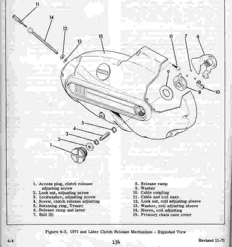

I mean washer number 9 ... i was measuring the primary hole almost all night long. So and I need washer with these diameters: thickness = 2.5 - 3 mm, D=50.5 - 49mm, d=24 - 30mm .. maybe it will be useful for somebody too

You could try a hardware store or a bolt specific store. May need to just order one to know you got it right. I don't remember one being there myself but it's been a while and it's a little different than my evo.

Yep, I try to buy it in our bolt store. I really want ride on my Iron!! Because the weather is so beautiful :-))))
