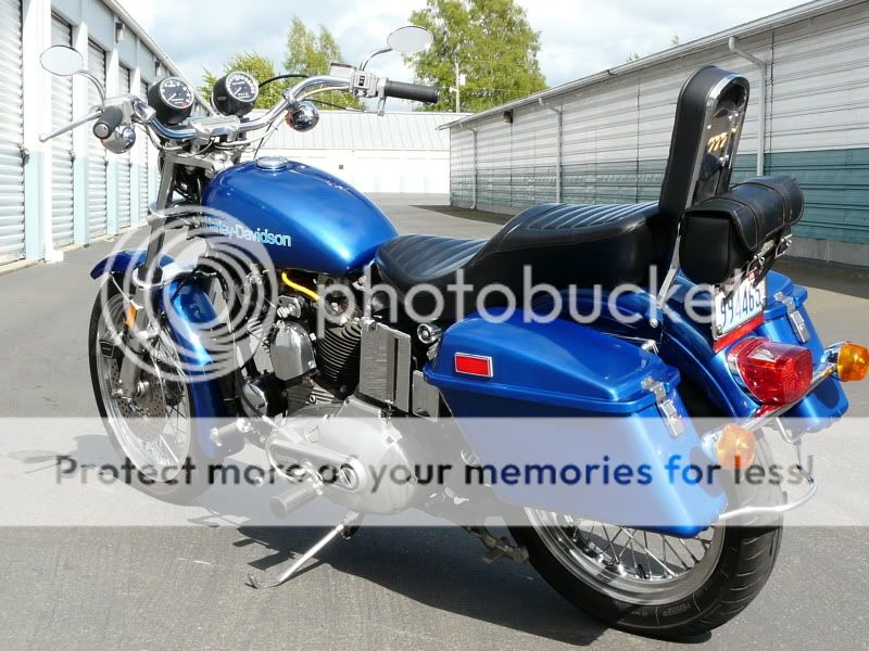

I'm also using a old superglide tank on my 74xlh, great tank. I used a couple of universal rubber hangers from an exaust for the tunnel horseshoe. I just cut the solid centers out of them with a hacksaw. They let the back of the tank drop to a height that looks good & allows the spring to hold the tank tight to the backbone of the frame.
Me & big griff out for a ride last winter, he's on my 74xlh & I'm on my 80xls roadster.
