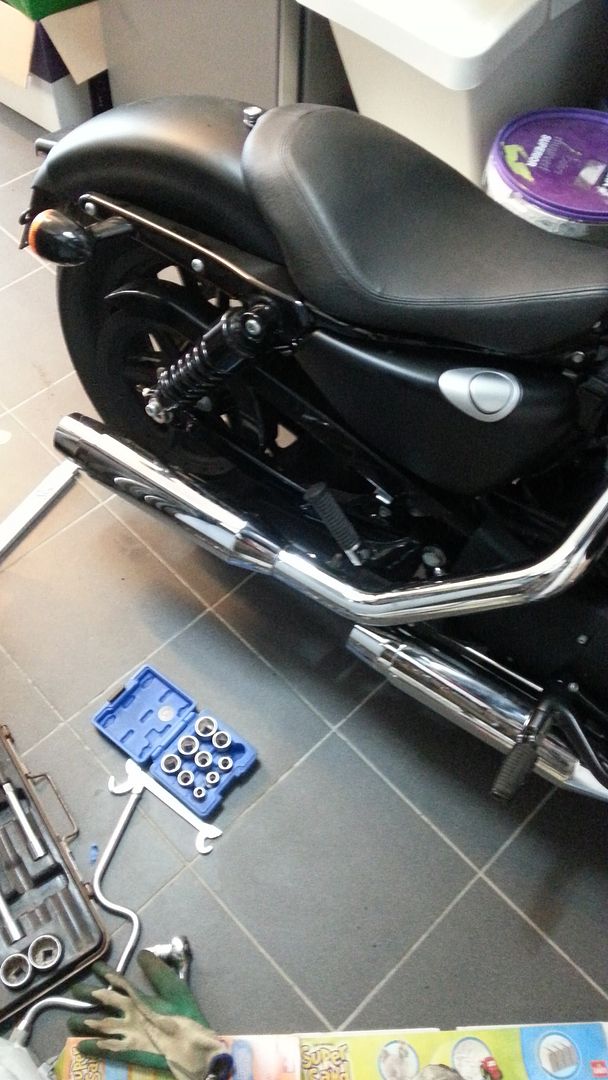

The TTI W158 set is on it's way to Belgium.... I couldn't wait so i have started working on my stock pipes already....
This is how the bike looks now
For the preparations
Some cutting...
Back on the bike...
Damn...this is loud...but when I ride it I really notice a loss in power and torque...
I can't wait for the W158 to arrive so I can find out for myself what all the fuss is about ;-)

OK, finally.... No rain...no freezing cold...
At long last i can go for a ride and test out the TTI.....and after a two houd ride...is this my review...
First of all, i have bought from DK customs before...and they really rock! Just 7 days after my order i had 'em in my hand... All the way from the US of A to rainy Belgium. Thumbs up for that guys.
Then the placement... It really is as easy as stealing candy from a baby. I idd al the work with onlny a dremel and Some wrenches...o yeah...and a drill.
I installed the TTI's with the threaded bolt towards the engine, About 1 1/5 inch from the muffler end.
OK... For the result.... When i've cut out the guts from the mufflers i took the bike out for a run... The sound was loud....damn it was loud! And it wasn't too bad either, i could live with that sound...so so far i was happy. Then for the ride... There was a loss in power... Not dramaticly but noticeble.
Now with the inserts... It's still loud! Yeah baby....and even better...the sound is deeper. Roadtest... First gear....i do not notice a vertelt big increase in power, actually i do not notice anything.... Then i kick iT into second gear and crank open the throttle... Damn... It was all true... Definit more power in the lower rpm's even in the mids.
i love that bike even more now.... I never thought i could have a bike that sounds like a real Harley and rides great without having to spend a small fortune. I have waited way too long....
