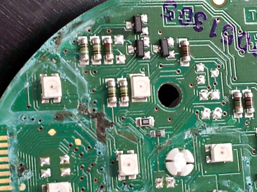

Additionally, although quite rare from my experience, is damage within the speedometer itself. this tends to cause all manner of speedo related issues obviously, including the tell tale light cluster not working
Speedometer disassembled
Circuit board damage inside speedometer

Reputation points for the photos and the time you put into your replies.

man I like this dude!! gets into the meat of the issue. surface mount is challenging but do-able for repairs.
