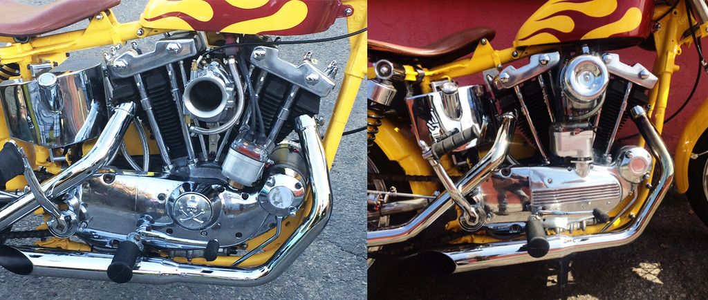

Default not to say it cant be done
The old style cover can be fitted to to a 77 up engine the cover must be machined and a new pinion bushing fitted. Someone has a thread covering the swap and mods required http://xlforum.net/forums/s...gneto+retrofit

Default 1972 mag cam cover needed
Originally Posted by Lucky7Racing View Post
Here is my answer to using the tach drive mag...
Hello a mag just fell into my lap and I'm working on a chopper '72xlch. I was looking for a com cover that would allow me to run the mag. Is anyone holding a modified cover or could direct me to someone who could machine one for me? Thanks
Or at the very least drop me some detailed info how to do it.
Old 4 Days Ago
Location: Phoenix
Posts: 2,287
Sportster/Buell Year: 1964
Sportster/Buell Year #2: 1971
Reputation: 1657727
Post a pic of the mag you have.
