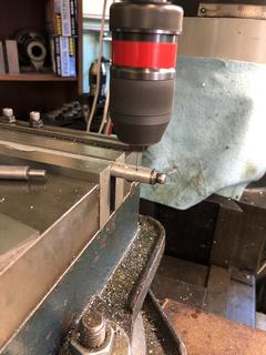

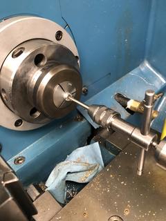

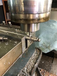

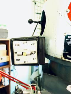

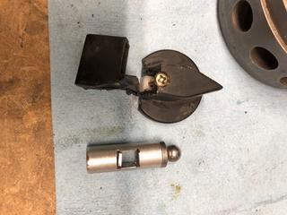

It’s been 4 weeks since anyone posted here. Time to bump this thread with an Ironhead part pic set.
The plastic pointer switch knob on my mill broke again yesterday and it’s so oil soaked no glue will hold. So...I machined an old Ironhead push rod to replace it.

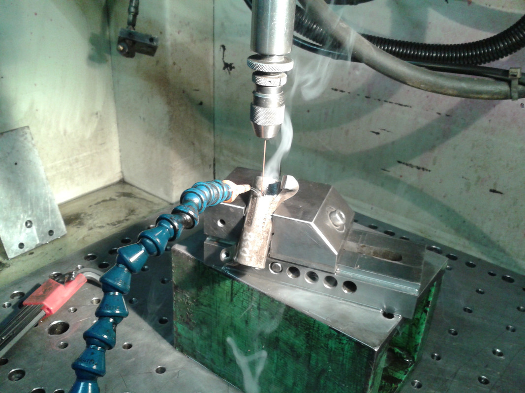

Using an EDM to burn the hole in the exhaust rocker that cools the exhaust spring.
After breaking a few small drills......
Don't bother trying to drill the rockers they are really hard.
