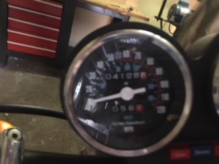

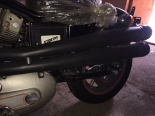

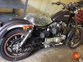

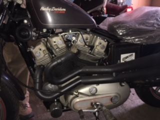

I buy,improve and sell houses for a living. My most recent purchase came with 3 motor cycles. A 1985 Yamaha VMAX (first year with the VMAX), 2008 HD Dyna Superglide 3,200 Miles, 1983 XR1000 4,100 miles all stock except the carbs.
I'm selling the other but thinking of keeping the XR. I don't know how long the XR sat. Mikuni VM38-9 round slide carbs. One of the slides was stuck and I freed it with a heat gun. Removed all carbs parts and socked in gallon of carb cleaner. Used rebuild kit to put carbs back together and struggled to start the bike without giving it throttle. Choke would not start bike without throttle.
Spoke with a harley repair man and he said to get 2 new carbs because the old gas had probably eaten away the current carbs.
Just ordered two new Mikuni VM38 Round Slide carbs.
THE BIG QUESTION! Does anyone have advice on the jetting/needle I should start with?
The VM 38 carbs that came with the non starting bike were jetted:
Needle - 6DH3
Slide - 2.0
Air Jet - 1.0
Main Jet 290
Pilot Jet - 20
Needle Jet - P5
The jetting that comes installed with the newly ordered VM38:
Air Jet - .5
Main Jet - 330
Pilot Jet - 30
Needle Jet - Q2
Would you start with the factory jets or the current owners jets? Current owner is deceased and I never met or spoke with him (Zero info on Bike)
