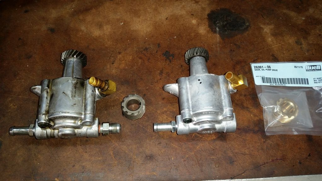

A view of the pre 2007 pump (2003 in this case) and the 2007 one. From the outside they are identical. The new one has a larger scavenge section. While you've got the cam chest open you might consider a bronze gear just for the peace of mind.
