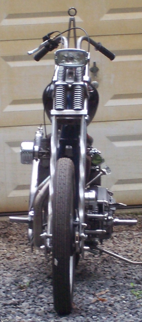

Still making progress,,,Another set of bars and re-did the rear brake pedal correctly to "Pull" the brake shoe lever instead of the longer push pedal I had....
Here is a shot with the "Rabbit Ear" bars I made to try for the feel.

Looking good!

Liking the new bars. I know that you've done a few custom iterations, but personally prefer the more traditional curve...runs a cleaner line from the forks which are a focal point. Awesome build.
