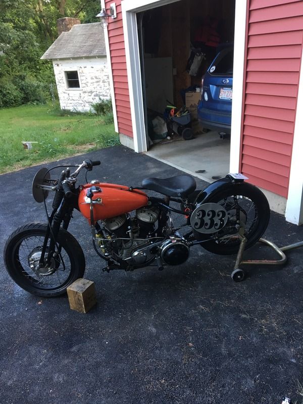

I truly understand the financial horrors of racing. I campaigned an XS650 sidecar many years ago and will be selling my Harley 45 racebike to finance this Sportster. Hadn't planned on replacing the crank assembly, but now you've got me thinking. I'm using the 1979 and later frame and plan to transplant a dual disc XS650 front end. I'll just relace the rear bub to an 18" rim. My current vintage racebike is a 250 cc Can Am dirtbike turned roadracer. It's faster than me. I'm slow, but I like to finish races. There are always people far more skilled then me on the track. This is embarrassing, but one of the magneto's biggest draws (run on on my 45) is that I always forget to charge the battery in a total loss system. I've learned that e-ignitions don't appreciate being asked to run on low voltage. Points don't seem to care. Maybe a voltmeter next to the tach will help? Anyway, here's photo of my non-Sportster racebike that is frustrating me, which is why I'll be selling it.
