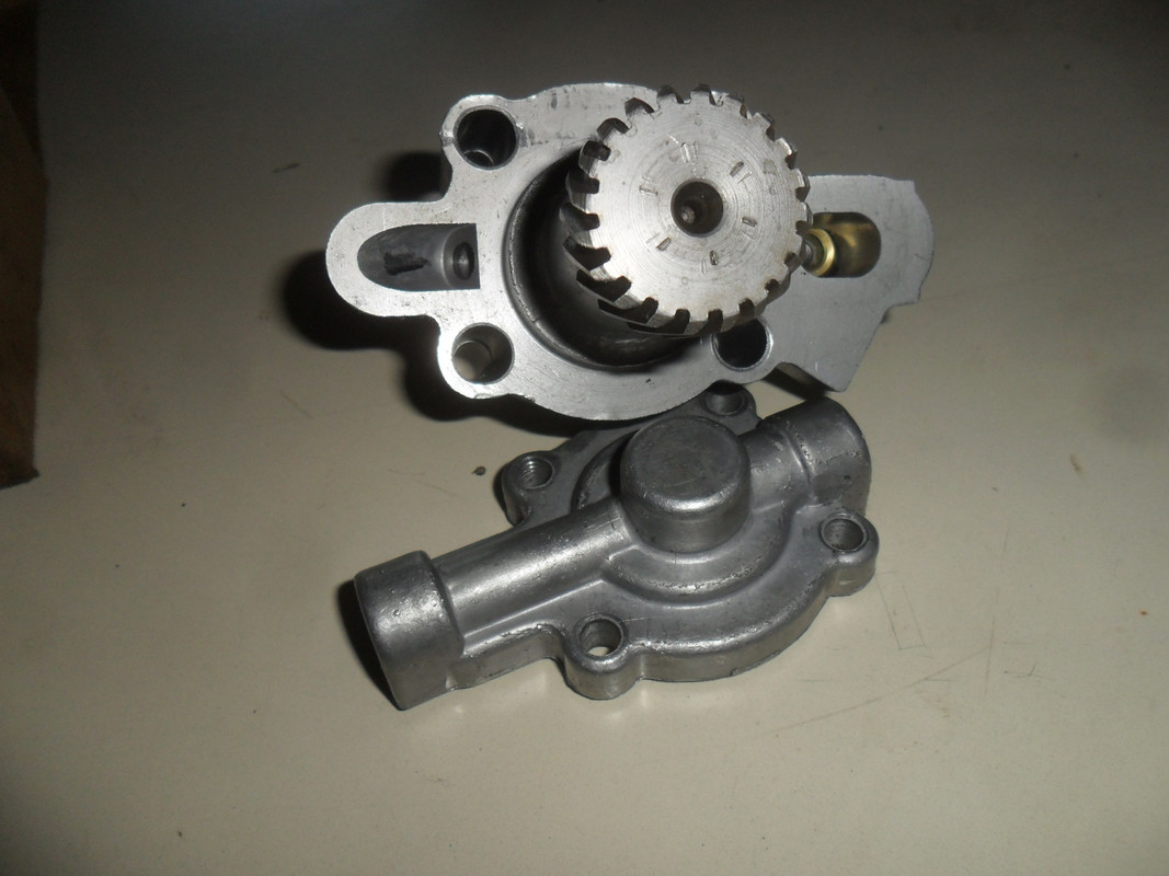

Hi Hippysmack,
Sorry to disturb you again with my existential questions...
I was so happy to find a NOS pump 1977 in france but when the seller sent the pics, I discover that this is exactly what I have, without the hole. I am now back to point zero....I wonder if my crank case cover is the right one.....If oil had to be sent to the engine by a hose through the hole I used for the pressure sender, where should it go ???
Jean-Luc
Old 4 Weeks Ago
Hippysmack's Avatar
Hippysmack Hippysmack is online now
Join Date: Jul 2014
Posts: 4,296
Sportster/Buell Year: 98
Other Motorcycle Year: 95
Reputation: 3696977
See that -86 in the cavity in the cover?
That is an 86-90 cover without a doubt.
I'm sorry to tell you but the seller is either ignorant or trying to pull a fast one on you.
I have seen the same thing on Ebay.
I actually contacted a seller to let them know I couldn't use the oil pump they had on auction.
But I did inform them they were mis-representing the year model.
They did relist it with the correct year model stated.
Some of them are honest folks who would sell a piece of dirt someone gave them as a precious crystal if the person they got it from said it was.
That's why I tried to give you as much history as I have compiled on these pumps so you could hopefully get what you need.But I would definitely pass that up as it is the same compilation of parts you already have.
edit:

Old 4 Weeks Ago
jlv jlv is offline
Posts: 12
Sportster/Buell Model: XL1000
Other Motorcycle Model: Dyna 1991, Honda CBX 1000
Other Motorcycle Year: 1981
Reputation: 11759
jlv is a glorious beacon of lightjlv is a glorious beacon of lightjlv is a glorious beacon of lightjlv is a glorious beacon of lightjlv is a glorious beacon of lightjlv is a glorious beacon of lightjlv is a glorious beacon of lightjlv is a glorious beacon of lightjlv is a glorious beacon of lightjlv is a glorious beacon of lightjlv is a glorious beacon of light
Talking
You are my hero of the day !!!!

Old 4 Weeks Ago
Hippysmack's Avatar
Join Date: Jul 2014
Posts: 4,296
Reputation: 3696977
Here's a used one for 224.99 (plus shipping to you):
https://www.ebay.com/itm/H3-Oil-Pump...ion=4#shpCntId
The seller didn't completely open it up but at least showed it with the cover off.
This reveals chamfered gerotors (77-E83)
Fine tuning that,
The fittings 'may' reveal more.
77-81 style oil pump, (1) 90° return and (1) 45° feed fitting.
82-E83 style oil pump, (1) 45° return and (1) 45° feed fitting.
L83-85 style oil pump, (1) 90° return and (1) 90° feed fitting.
Unless the cover is a mismatch (even though 77-85 style),
(2) 45 degree fittings reveal it as used in 82-E83 applications with the upgrades for that time frame.
The fittings were changed when oil tanks / line configurations were changed.
Also the arm in the body where the check valve sits is rounded on the edge.
Reveals 77-E83 also.
Most parts will interchange between the different pumps with the exception of;
Gerotors:
Either early or late style gerotor gears may be used with late style (under-cut) oil pump bodies and covers.
77-E83 style chamfered gerotor gears may (only) be used with early style oil pump bodies and covers.
(Use of late style gerotor gears in early style oil pump bodies and covers could cause the oil pump to bind up and possible pump failure).
Outer Plate:
The outer plate had a design change at the bore for the gearshaft.
The outer plate seal changed to mate up with the new design.
So, they fit together as a unit.
Either plate matched with it's correct seal will work on 77-85 pumps.
I apologize for all the edits but I can't remember it all since there were so many particulars to 77-85 pumps.
That's why it's good to refer to the pedia with all the info already compiled there.
All the parts lists and upgrades are listed here:
http://sportsterpedia.com/doku.php/techtalk:ihil03d
But the outer plate that should be in your pump now should look like the one on the left and is the better design over the original plate / seal combo.
The seal is hand pressed into the plate instead of just sitting in it as in previous.

Hell, I just took a closer look at that cover.
It looks to have light scratches as in a Used cover would look.
You probably won't hear back from the seller.
I believe he knows what he's done...
