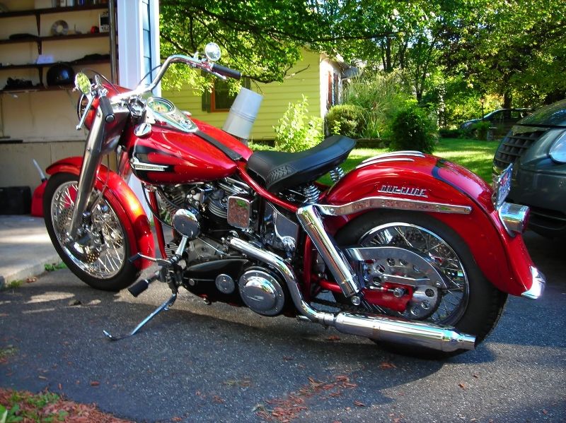

If you are looking for something that will help to absorb the road shocks from ruts, etc, that might be jarring for your back, then maybe consider a sprung solo seat. I mounted this one on my pan, simple because the ancient shocks were not particularly compliant. I have had a couple of solos on this bike, but the best by far is this one sourced from a HD Crossbones. The OEM Crossbones seats usually sell for around $200 on Ebay. They aren't as wide (only 17" at the widest point) as the larger Police style solos. Still not a "Sporty" looking seat, but you can't have everything. I used an amazingly well build stainless steel front hinge from Fabricator Kevin, then mounted up a set of 3" springs on the rear. This setup not only gives me a soft, comfortable seat but additionally helps to smooth out even the most "unexpected" potholes and ruts here in New England.
2002 Hugger, S&S 1200 conversion, Woods cam,SE ignition/coil, D&D Fat Cat
