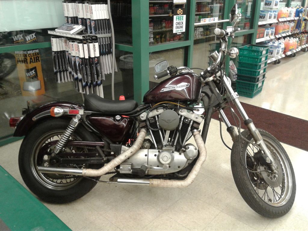

I've actually got the forward controls in hand. I'm thinking of mounting the shift side on it due to my bum knee...-we'll see if i get used to the present configuration or grow weary of it.
After some review-pretty sure all the tin was repainted- i'm calling it a plum metalflake. Seems like a wasted opportunity to throw in some purple pearl...
I know the frame mounted light may not be everyone's cup of tea, but i think some wide, low, fairly straight bars, 2 inch tank lift and tuck job on the wires would have the front looking very clean.

Hello, This last weekend i picked up an 82 XLH that i was told was a 25th anniversary model. Not sure about that due to the paint job- kind of a plum metalflake without the silver side panels and different badging that i love.
The PO removed forward controls, dash panel, and installed the small speedo and the wrapped pipes. He kept saying the tank might be fairly valuable- don't know about that- it's bigger than a peanut and i'm told the Anniversary models were bigger. I dunno if it is factory color, or a respray over an Anniversary or Non-Anniversary.
I like the bobber idea for these- would love to set the back down a bit, install lower, wider, flatter handlebars, trim the blinkers and even move the headlight to the left hand side down tube of frame- not sure if a solid mount iron head is a good fit for that- seen it on a magazine bike-but that could be for legality more than riding at night.
how does one shop for handle bars? there's a million. should i ride to nearest bike shop and play around with them holding them in basic position?
Also- PO gave me the old dual seat, and the backrest, front fender and the forward controls- i have a bum left knee- and i think the pipes conflict with forward controls- does anyone run forward controls on just the shifter side?
Will post pics after work
thanks in advance. Rick
Welcome from the crescent city, nice find, actually a very nice find!
The PO did you a favor by removing the forwards(IMNHO).
Those wrapped drag pipes are good on the dragstrip.... are you planning on drag racing it?
There are numerous things that I would change, but it's your bike and it's all about "customizing it" now to what you like.
I'd say that just a set of Pcams, some head work to flow in and out, the thin head gasket(making sure the fire ring doesn't bottom out)for a wee bit more compression, a 2 >1 exhaust or a crossover header with some cut off's (hole sawed the guts to 1-1/4"), a nice dialed in CV carb from an EVO, with a high flow K&N air filter, would do the trick for me,,,,,,, but heey, is your bike, ENJOY!!!

Thanks! It's already got a better carb on it. Considering the other stuff done to it, I'm wondering if it already has mild cams but not sure. I'm not going to race it (much) but I love the pipes and the sound. To me it's a toy to unwind to and from work and maybe go to dinner. Basically a bar hopper but I don't go to bars. Working 2 jobs for past several years, plus finding time for family doesn't leave much time for long trips. I just want to get out and rip it a bit and be in a good mood when I get home to see my girls.
