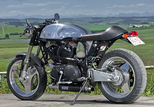

Well, the Buells had the Sportster motor in a chassis that handled, with the adjustable upside-down forks and monoshock that you want. I'd agree that a cafe racer needs a somewhat homegrown look to it, but the Buells were a good basis for that. Here's just one example, where the owner has achieved a real classic look...

Myles- I'm with you 100% on this one, an excellant example.

That Buell looks great. Anyone know what that exhaust is? That would give me the cornering clearance I need and open up the whole world of options for rear sets.

If you mean this Buell...
... those are stock Buell headers with an aftermarket muffler (which is in the same place as the stock Buell muffler). I've seen it done on Sportsters - you just have to rig up a bracket to hold the muffler under the frame. Buell engines sit a little higher than Sportsters, so you may have to watch your ground clearance riding up kerbs, etc, but it would certainly give a lot more clearance when leaning the bike through bends. And yes, rearsets would not be an issue.
Do you not have to watch for the front exhaust pipe clearence issues with the Buell pipes on a sportster?, Seem to think someone said its a tight fit & can require a bend/kink put in the pipe to clear the frame?..
Quite possibly, as Buells have no lower frame rails. That's a partickerly fine example!
