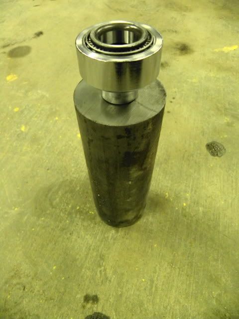

Here is a little project I am working on for a member here. The Ironhead I am building has had a Honda CB 750 front end fitted to it. In order to make the conversion, special neck cups need to be made. 3" round bar is turned down in the lathe .001" at a time and must be precise in almost every area of the piece. Timkin tapered bearings are used and races are pressed in. They take nearly 5 hours per cup to produce.

That looks like a 'before' pic? Where's the after (cup) pic?

The cup sitting on top of the round bar is the cup I made. In a way this is both a before and after picture.

is that mild steel? I thought neck cups were hardened.

Neck cups arent' hardened (at least none of them I've ever seen are). Only the race is.

Unless your lathe is underpowered, there's no reason to take .001" cuts to remove large amounts of "waste" material. A single .125" cut will save 124 .001" cuts. That's a LOT of time saved. If your lahet is underpowered, then kudos for having the patience to make do with what you have.

Neither one of our lathes is underpowered.I do make bigger cuts, but only to rough cut. I dont like beating up bits, thats all. I enjoy it so thats all I really care about.
If I wrote down all the cuts I made, this post would have been way over the top for most people to enjoy. I dont like to get all technical and try to be above everyone else.

I'm with rivethog, don't see 5 hrs for that neck cup. Take large metal removing cuts until you get down to .010 of the size you want, then shave it down to perfrction. My machinest friend at the machine shop says he never takes less than .040 cut (.080 total diameter) to remove unwanted metal. Thats on a large lathe, I have a small lathe and usually cut .015 to .020 off for waste material.
Work looks good, I assume the cup you made will be welded to the neck, or is it placed in the original neck cups?

Alan, they are made to slip fit into the frame just like big twin neck cups. That way it can be reversed if ever needed.
