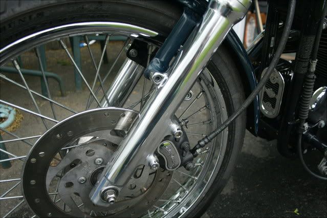

several threads here on the subject, lots of us have done it, including me.
and I didnt take the fron end apart, just the wheel & the fender.

thanks. it took about 8 hrs to do
