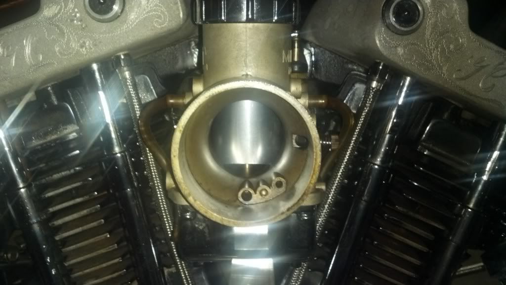

Hopefully this picture will clarify.
I am referring the three holes at the bottom of the opening, specifically the one to the left. Also, this is how far the slide goes down. Is that the proper place for throttle completely off?

Ben,
I just saw your pic of the end of the carb and yes, the slide looks to be closed down.
The air jet does go in the left hole.
The middle hole is closed off.
The right hole does allow you to view the end of the air screw.
So everything in the pic is as it should be.
On the side we are looking at the slide has the cutout which shows.
On the other side of the slide.....that face should be 'almost' all the way down. The idle screw adjustment screw elevates the slide just a bit depending on how far it is screwed in.
Too much and the result is a fast idle because the slide has been raised too much.
But yours looks about right in the pic.
Sometimes the Mikuni slide will hang just a bit when you first install the slide back in the carb.
A couple of throttle twists will seat it down should this occur.
So if the jet holes are clear you are about ready to start it up.
