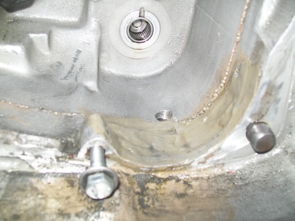

question. looking at tha cases have they been welded?? around the middle?looks like a weld around the inside of cases. ? or just the way it looks. dont rember then with the bead look inside. lots were . . ??gar
No

garbiker is a jewel in the roughgarbiker is a jewel in the roughgarbiker is a jewel in the roughgarbiker is a jewel in the roughgarbiker is a jewel in the roughgarbiker is a jewel in the roughgarbiker is a jewel in the roughgarbiker is a jewel in the roughgarbiker is a jewel in the roughgarbiker is a jewel in the roughgarbiker is a jewel in the rough
ok . just looking at the inside. had one that was welded and was not lined up. and had a problem . cu gar .

not real sure about this, having never seen one before! so probably am missing it, that would be my luck. got a pic of what it's supposed to look like? is that slot right above the cs needle bearing where it goes? yeah, i'm sure that race spun around in there to get out of "clock" like that - not to mention the chipped edges of the flange. if it didn't spin then those chipped areas should've been centralized to the left side of it (as you are facing the photo - make sense) as the shaft canted toward the rear of the bike and low gear dug into it, right? is it pretty safe to say i need to get my race at least one size over because of this, or go with standard? i am definitely changing out both cs bearings. seems like it'd be a waste not to when into it this far - especially considering the small cost of the parts.
as it turns out, the left side case has been repaired in the past - i can't sit here and believe that the po didn't know about this when he sold it to me - grrrr. i noticed it the first time i changed the oil/primary juice. here's a better shot...
if you were to look at the underside of the belly you'd see a repair section about as wide and long as your index finger - left case only, right case no repairs, at least not visible. no idea who repaired the case or when.
