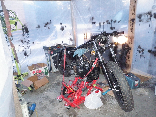

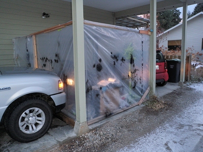

Default Then it got cold..needed a Garage
We've been calling this my "Dexter Garage" all winter. Using a borrowed propane heater and bright lights from a friend, I was able to work evenings and weekends during the cold weather in comfort:

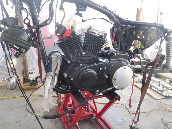

Default Reassembly
I'm including this mostly so you can see my garage from the inside. By this point, I had painted the forks, wheels, and the engine was almost put back together.

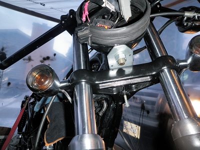

Default Headlight relocation
I never much cared for the eyebrow, so I tapped the bottom tripple-t and created a bracket to bolt into it.
The bracket still needs to be painted, and I need to add curved washers so I can adjust the tilt of the light, but it's solid:
Underside:

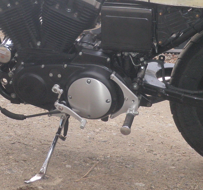

Default Chainsikle Rearsets
Since my bike had forward controls, I needed to change to either rearsets or mid controls. I couldn't find a decent price on used mid controls, and even though I was hesitant regarding comfort, I decided to send Shane at Chainsikle an email.
I saw on another forum user that Shane came up with a new style that removed the boomerang from the shift side. Because I'm 5'11" and a bum knee, I wanted an option for a lower position. Shane was quick (real quick) to accommodate. I emailed him on Saturday, he sent photos with ideas, I ordered them Sunday late at night and he started on them right away. Was done in less than 5 days!
Brake Side : (Yes, I have a new brake cable coming)
Shifter Side:
