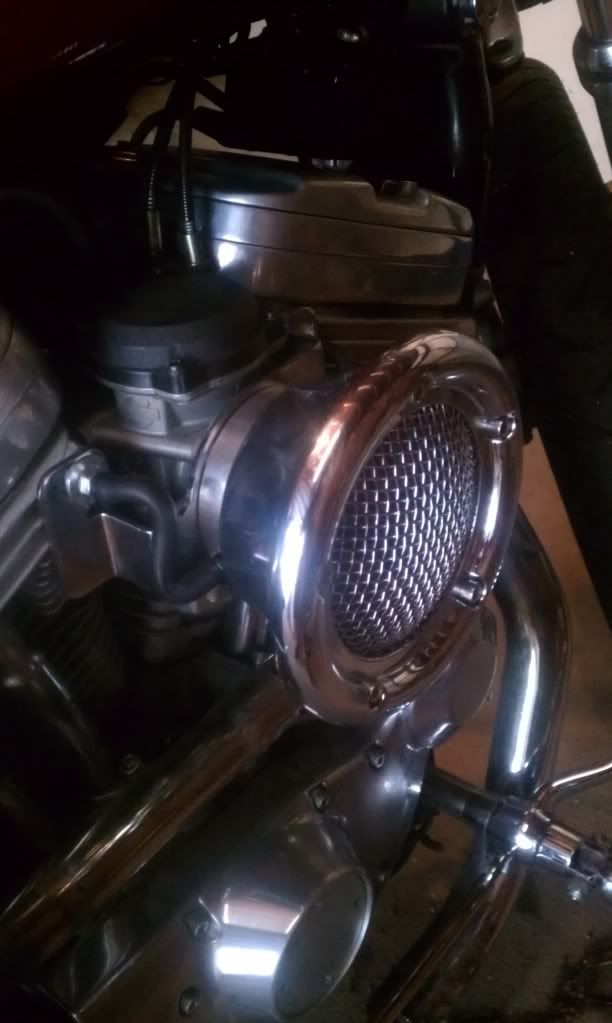

I have a 1998 883 hugger. The person i bought the bike from installed a 1200 kit on the bike, and also has drag pipes with no baffles. I put a velocity stack intake on the bike this weekend. I rode the bike which seemed fine when your giving it throttle but when you are at a constant speed it almost feels like the engine is cutting in and out. ( and after reading through this forum and talking to the hd dealer i bought a slow 45 jet and a 180 main jet) which i installed the next day because i figured i was not getting the fuel i needed....when i took the carb off i found the owner before me had a 48 slow jet and a 160 main jet installed...I put the 45 and 180 jet in and rode it again and the same thing is happening except i believe it feels a little better but def not ridable for long ....my question is what jet size should i have with this setup so my bike is back to normal...also one small note, when i put the jets in i also installed the kit from dkcustoms that relocates the coil...do you think moving the wires around could be causing this issue i am having. i dont believe the spark plug wires have been ever changed and the bike has 15,000 miles on it. Thank you.

Can you post a photo of the velocity stack so i can see it?
All times are GMT +1. The time now is 19:03.
