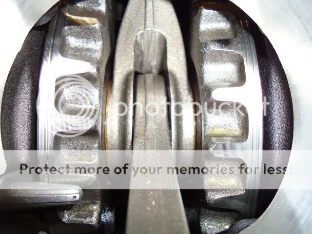

I had a friend grind the clearance on the inboard side of the cam lobes of #2 and #3 so they wouldn’t hit the bearing race of the crankshaft. This can be done by hand on a bench grinder or with a die grinder too. I had access to an OD grinder and a guy that knows how to use one. So I figured why not?

And then buttoned up the cam chest. After that I installed the rear cylinder and unfortunately scored it. That was putting it mildly.
I sent it back to HAMMER DAN to see if he could fix it. Sadly he could not, but was gracious enough to sell me another at his cost. How cool is that!!! HAMMER DAN is the man! Thanks Dan.
I was feeling lucky, so then I installed the front cylinder! Not without incident though. I pushed the piston out of the cylinder and had to reinstall it. What a pita without a compressor. At this point it was time to clean up the garage again. Time: 11.0 hrs
