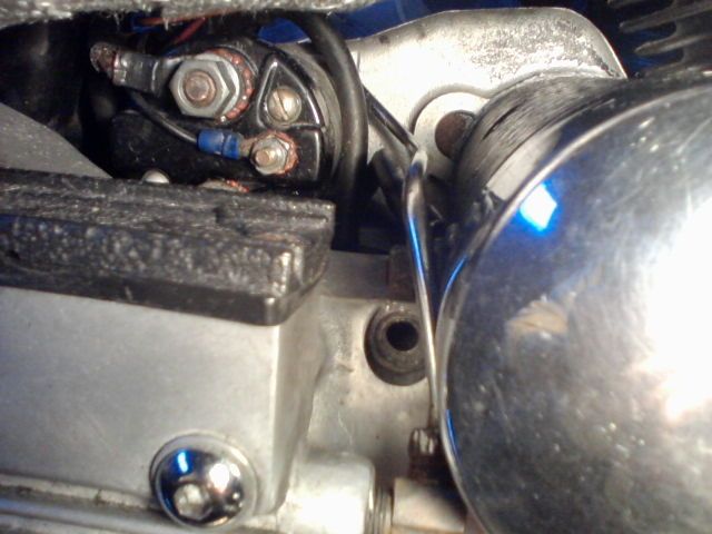

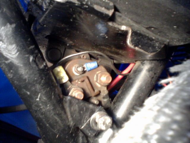

Thanks IronMick. It is the main CB that is tripping. About a month ago, the breaker tripped a couple times immediately when I hit the start button. I thought the breaker was bad, so I replaced it with a OEM H.D. part (approx. $15) charged the battery, and the problem went away until now.
I'm pretty sure the short is internal to the relay or solenoid. It could be one of those wires, but impossible to see the whole length of the wires without removing the components. I cleaned the terminals.
I did very quickly jump the starter terminal and starter spins free while not engaged.
Just by judging the external cosmetics of the solenoid and relay, if the internals are the same in age and lifespan, I would guess both are due to be replaced. Corroded and plastic covers cracked, etc.
I got some crappy cell phone pics. Sorry, best I can do.
Pic of solenoid on 1979, hard to see how tight it is to the sprocket cover and rear brake cylinder. I think the missing bolt in cover was left out by the PO because the starter terminal is so close. Also, there is no mounting bracket/strap on the starter as is shown in Clymer book.
Pic of relay, this thing is really squeezed in there under the battery box, can't even remove the one terminal unless I unbolt it:

A modern cube-type 30 amp relay, from any auto parts supplier, Princess Auto, Harbor Freight, etc will work - probably better than another of those original style ones. Install it up under the seat. Just do not mount it with the wires pointing up like i did - water gets into it ...
You can buy a rebuild kit for the solenoid. It includes a new plastic top. Tighten those bolts just enough to close up the split lock washers, no more. It probably needs to be dismantled, cleaned, inspected, rebuilt. The internal parts wear out.
There is a large copper [steel in newer cheaper solenoids] washer that contacts the inner end of the two copper studs - that is the click that you hear. The copper studs wear down where the contact is made. And it usually gets filthy in there.
What i have done is simply rotated the studs to use the non-worn side.
After you rebuild the solenoid use my YouTube video to bench test it before installing it.
There is one wire [red] going into the MAIN cb from the battery +, and two [both red] coming out, one to the B terminal on the ignition key switch, the other to the starter relay. Short has to be on one of these, or inside one of the components.
You could do a voltage drop test on these two wires - measure voltage at each end and see how much loss there is. These are direct from batt +, always "hot" so you do not need key on or engine running.
