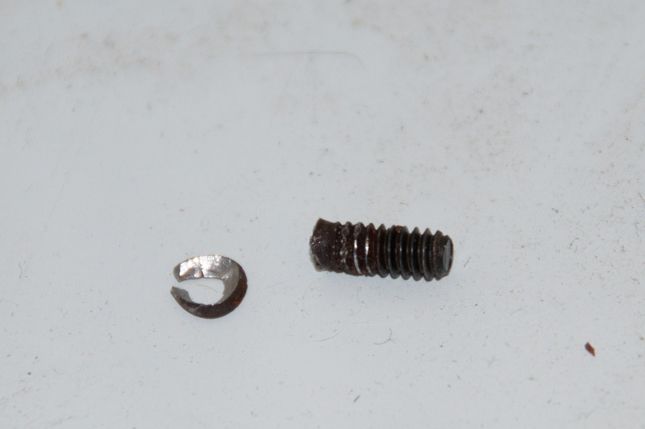

Nothing fancy, but comfortable and practical. But of course this is about where the story gets derailed again. The screws on my switch housing were very rusted and not in good condition. I'd tried some penetrating fluid over night, and did have success on removing three out of four screws without drama. But of course I still managed to round out the last one to the point where I couldn't get the sucker out. So after getting advice and giving it some consideration, I took a few deep steadying breaths and drilled out the head of the screw.
Finally got it off there!
Only some superficial grinding on the housing. Hopefully won't be too noticeable with a replacement screw. Which of course leads back to that sentence... only I now need to also add ON A SUNDAY it isn't all that easy to obtain Imperial sized hardware in Australia.
So this is where installment 1 of this thread ends while I wait on some free days and some more hardware... no riding to work this week it seems. I can't get my Vibranators out of my stock bars either, so am contemplating whether to order another set. But in the meantime I'll close out with a photo of what's left of the culprit that will keep me on four wheels this week.

The hand control screw I rounded out was actually an allen head that I'd replaced a few years back because the torx looked a bit dodgy after I'd had it on and off a few times (I'm ham fisted too Paul; I was originally a mollydooker, but after a bad break of my left arm, became right-handed. It just means I don't quite have the dexterity I'd like.) I vaguely remember at the time trying to get the size in SS and not having luck. Well apparently I didn't get it in grade 5 either as it was rusted AND soft. But it is out now and installment part 2 is scheduled for this weekend.
