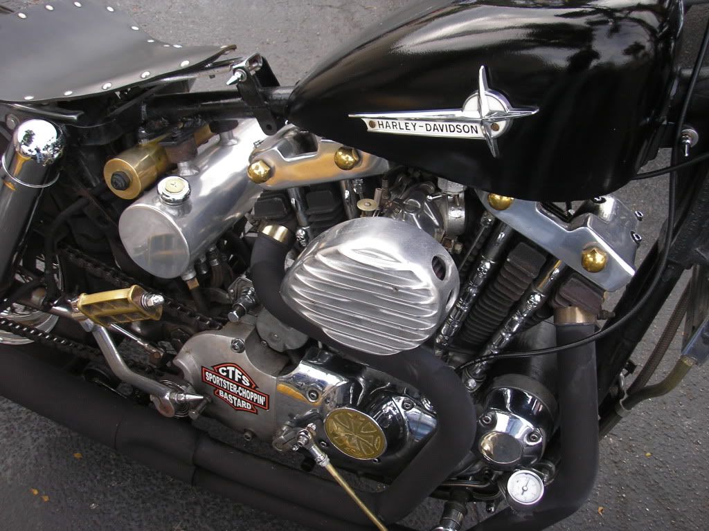

Default Russ, I'm surprised you didn't run the gauge...
...off of the front of the pump, where the sensor normally goes.
I used one of those flexible braided rocker box oil lines and mounted the gauge just off of my forward controls.
I can clearly see it, registering a true reading, even when I'm riding.

Me too, a tee direct from the oil pump just before the switch. One time i ran the hose up to the steering head, another to the handlebar. Just need tiny hose, 1/8" ID is plenty.

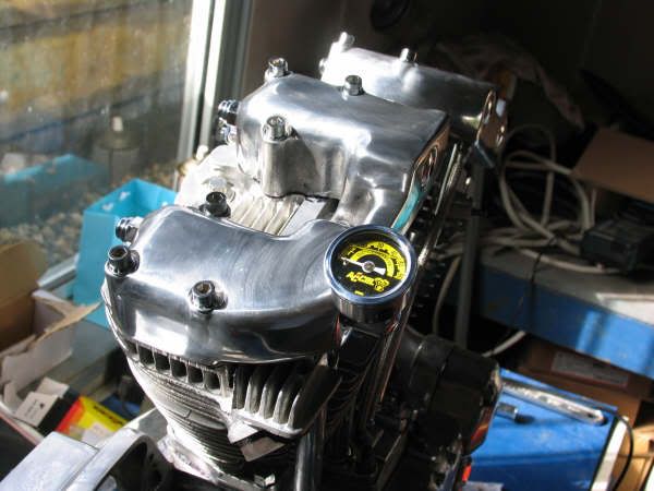

And I will once again throw my two cents in again on this subject.
1.) Does the Sportster produce oil pressure at the rockerbox....... YES IT DOES.
3 to 5 pounds at idle (hot) 15+ (cold)
2.) The Iron head will not show any pressure at running speed and temp..... False
If it is not showing pressure you may want to rebuild the pump or the entire motor.
3.) Use a 0 - 15 gauge, although it will max out with a cold motor it will hold up jusr fine and give you a readable number running hot at an idle and will show 7 - 10 running road speed.
A 0 - 30 gauge is only useful at cold temp, a 0 - 60 is as useless as tits on a boar hog.
All of this depends on the oil you are running multiple Viscosity oils will show low to no at running hot or cold idle. 50 weight in the summer shows lower pressure, 60 Weight is king.

+1. My experience reflects all of this as well.

A -Remove the oil pressure sending unit or keep it and attach a T brass fitting
B - Run a hose (AN-3) to your oil pressure gauge
