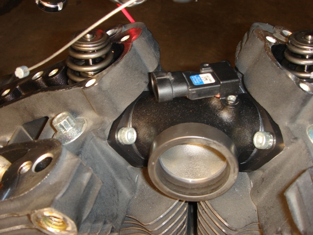

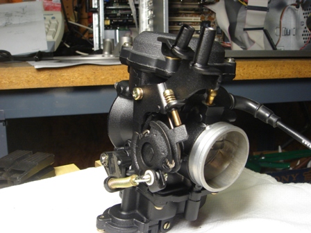

Here are some before and after shots of the carb, just finished it this evening

Yea thanks, I used a good carb cleaner on it, and heat it up to outgas it....
The powder is extra fine texture black from absolute powder coating. The black wrinkle from columbia is a much more leathery type surface. This texture matches pretty good with the texture harley uses on the block, except it has a satin finish and won't catch a nail like the really rough sand paper like stuff harley uses. It is much easier to wipe down and clean. So it has a more gloss than the block. The biggest thing as you know is masking things off cleanly. I over tape everything then come back with a number 11 xacto blade a trim out all the gasket surfaces. This makes for a clean job. Also I use the high temp plugs for any holes.
Here is another shot of it.
