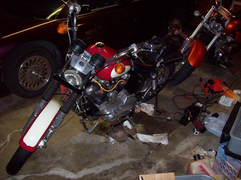

Default Fuel line routing

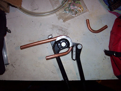

I tried the typical rubber fuel line first, but no matter what I did it was either kinking or tapping the head -- the new tank I mounted to my bike has its petcock mounted way down under, closer to the frame. I tried a copper tube next, but it looked like crap.
I came up with a hybrid solution. Make the bends out of 1/4" copper tubing and thread the rubber tube around it.
Bend the tube, cut the tube:
And feed it into the tube -- a little oil helps:
Looks like this mounted:
I'm happy with out it turned out. Figured I'd share it in case anybody else is interested. I still need to field test it, though.

Here's an old school fix for the hose making contact with the head. Take a thin wire coil spring, slide it over the hose and stretch it out some. This will keep the fuel line from making contact with the head. J&P Cycles also sells something similar for under $20. You can find it here:

Or you could have got a new gas tap with the spiggot coming out the rear, right next to the connection on the carb, that is how they run stock. I kinda like the magic s-bend rubber hose though.

think it looks clean, good idea too

Nice job on the fuel line.
