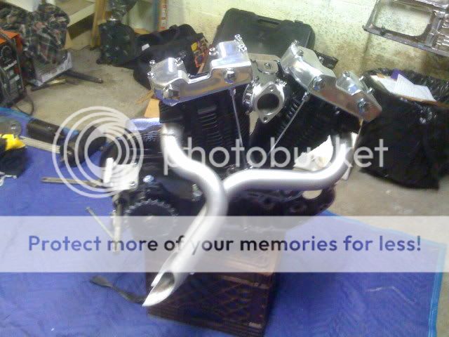

i replaced my stock P cams with some andrews Y grinds.
now my bike is a lil peppier than before
BUT it's still lacking.
could i need to up my main jet, and my thunder jet jet.
the carb is a super E
i also have some really short pipes that have the lollipop mod.
changing pipes is not an option.
pic of the pipes.

Sweet ass tubes! Is their any leg interference? As for your Q about the jets, sorry, just using the S&S alone.

Sorry with those pipes it will always be lacking, they look cool as hell but but performance will suffer and tuning will be very difficult. You should read jetting 101 on here and follow it untill you get it close then get a dyno run with an AFR chart to check it.

well i just got off the phone with one of my friends who went to MIT and another motorcycle school
and now he builds buell race motors for a living.
he told me to get rid of my Badass pipes i made.
my plugs are on the lite beige color so i need to up the main jet size a lil right now i have an .76 in it.
i'm looking at the paugho up sweep drag pipes.

Your friend is a smart fella. Someone else had the same advice here too. Try 1.75" drags starting @ 40" long. Those you can tune. Those you can ride. That engine looks great, by the way. Nice build.
