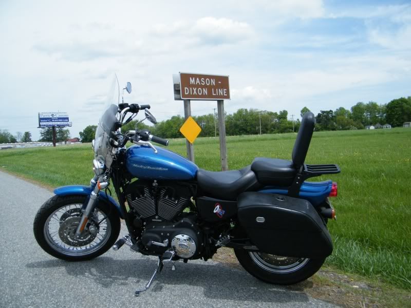

I have the Kuryakyn Switchblade pegs on my bike for both positions. I also have the hard leather bags. My wife's feet are larger than most ladies and when she has her feet on the pegs we are normally fine. Once in a while she will slide her feet forward and I get kicked in the achilles tendon when I stop and have to put my feet down. As long as she remembers to slide her feet back when stopping there should be no problems.
Here's a pic of the bike with the bags. I can get a close up when I get home showing the pegs. You will most likely need to move your turnsignals to make room.
