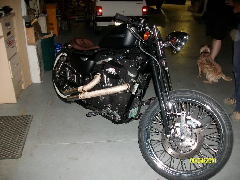

There have been a few guys on the Forum that have fitted, DNA Style Springers on to 04 and up, The Neck on 04 and up is recessed back into the Frame more than Pre 04 Bikes. What happens is you dont get any turning circle as the lower Tree fits the Frame.
To fix this some of them have Notched the Frame.
In my view this is very Dangerous .
I fitted on one to a Iron for a friend , what I did was Mill out the Lower Tree on the Springer to safely give all the Clearance that was needed, I also fitted a Spacer under the Lower Bearing just to help lift the Frame for a little more Turn.
You also need to move the Gas Tank back about 1"
