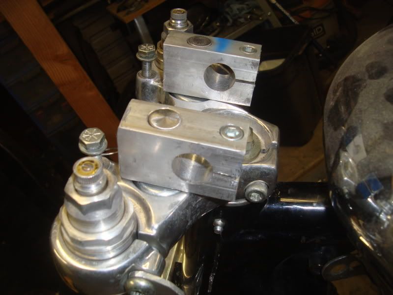

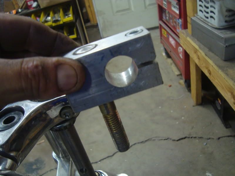

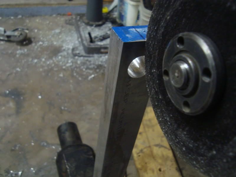

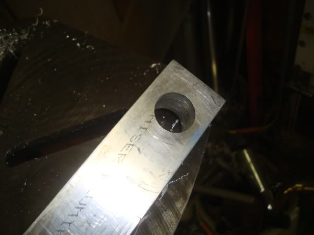

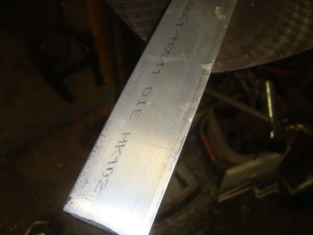

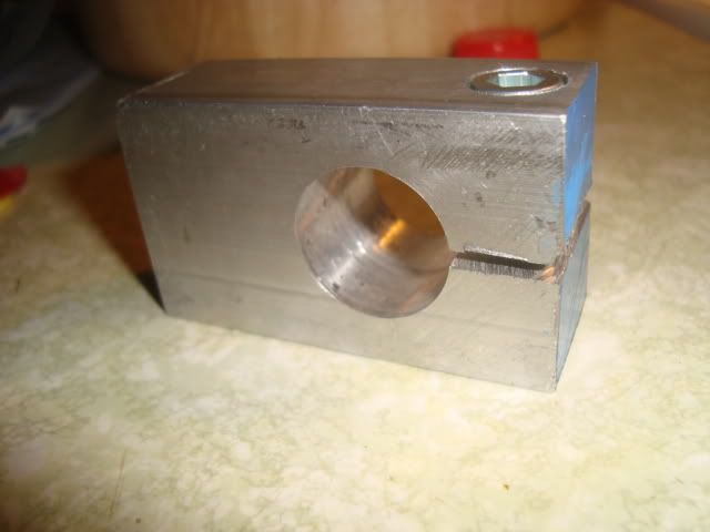

I made some offset risers so I can lean forward a little more and bring the bars a little closer. This also allows me to slide the 1200S forks up in the tree without hitting the bar. I still need to cut the forward pinch slot but I need to find someone with a mill to profile them for me.
Bar stock
drill bar stock to 7/8
cut pinch slot
drill, counterbore, tap
the forward pinch bolt is actually the riser mounting bolt, drill and counterbore
Here is what they look like on the bike. Just a little more work and I'm stoked. Total time invested so far about 4 hours. Cost so far about 4 bucks. Tools used are drill press, angle grinder and center punch.

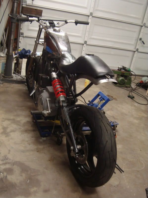

paint is done, think the color choice looks bitchin'! Its Black hammertone
new battery mount- reminds me of old ducati superbikes

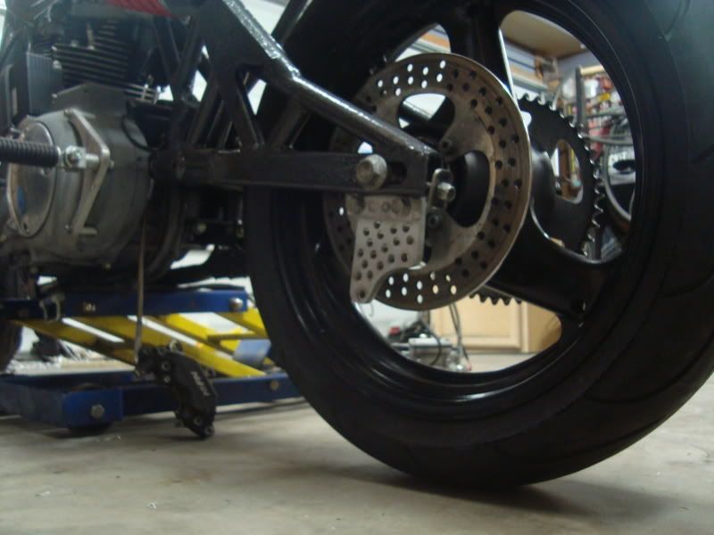

drilled out the brake mount
some detail shots-

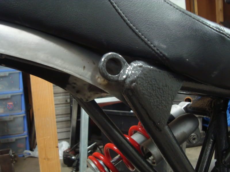

tie down points
threaded inserts welded into old triangle tubes- good for whatever
